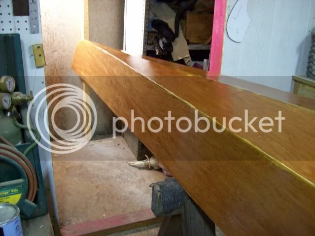

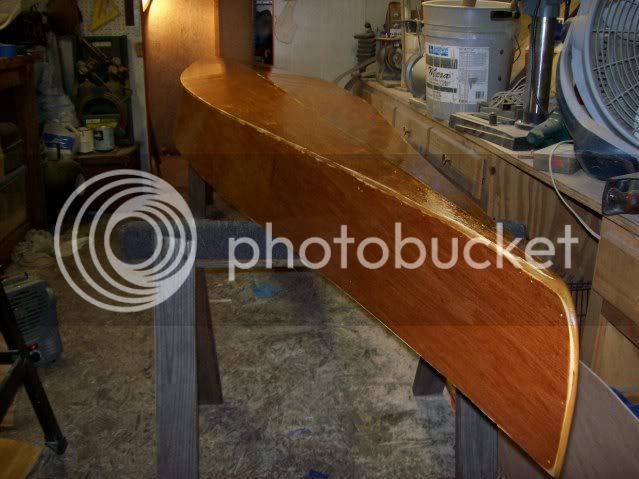

I have the weekend off and the weather looks to be dry but cold. Finally able to put a saturation coat on the kayak.
I found out, even if you are carefull, it's too easy to sand through the top veneer on the luan. Luckily, all those sand throughs are going to be hidden under the graphite coat. I should be able to get the glass on and at least one fill coat this weekend. I feel as if I've turned a corner and am gaining momentum.

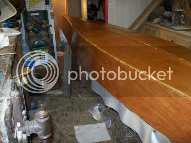

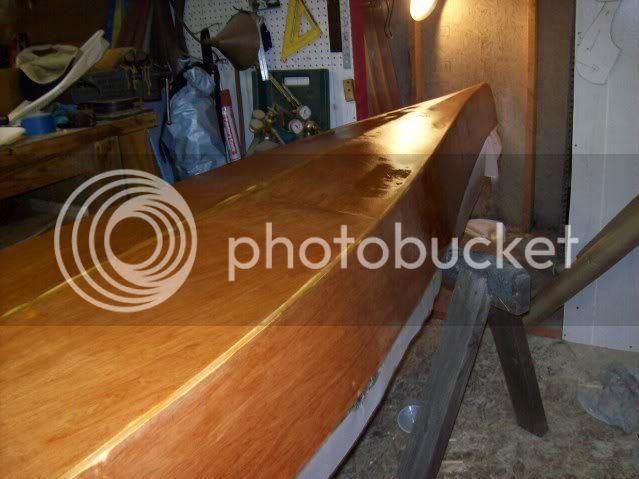

The glass is on the kayak. The operation was "interesting", to say the least. Learned a couple more words. I really do need a bigger shop if I'm going to build more boats.
I want to add some extra glass on the high wear areas on the bow and stern. Can I put that on after the epoxy sets up,but still tacky? With the slow hardener, it will be fairly tacky tomorrow morning.

Yep, that shouldn't be any problem.
