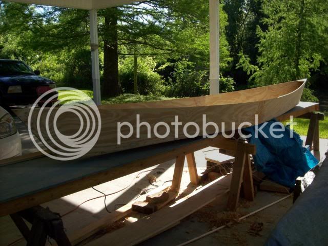

The bottom is on, decks are on, gunnels are scarfed and glued. I weighed her this morning, including the gunnels........ 42 lbs before paint. Quite a bit under 50 lbs finished. :D
She was coming out so good I contemplated going with a bright finish inside. Well, that got shot all to hell. :x I had 4 or 5 nails that missed the center of the chines and poked out on the interior. No problem. Ground them below the surface and dabbed a little thickened epoxy on them. Well, the debris from the nails reacted with the wood and stained it black wherever it landed. No real harm done, so the interior will be painted as per original plans.

Catfish, I'll paint a moon on a black bottom and the fish will think it's night time and start biting. :lol:
Chuck, that plain old pine sure would have looked impressive finished bright. Since it's mostly the surfaces and edges of the chines, I thought about maybe painting them the outside color and finishing the rest bright. We'll see , when the time comes.
Yeah, Ron, I think 2" of rocker will do fine. It's not going to be tourer. I'll be mostly paddling less than 2 miles to get to the fishing spots. She'll make a dandy pond hopper too.

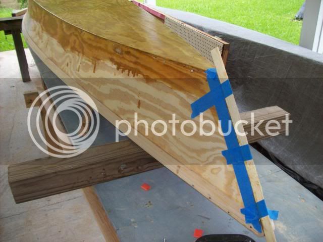

I installed the gunnels this evening. Everything went according to plan............for a change. :roll: Stiffened it up considerably. Still, I think it might need a thwart or one or two side ribs.
The douglas fir I used on the gunnels of my first two pirogues was heavy as heck but had the strength and stiffness to match. This western red cedar is really some light and weak stuff. I probably could have gone thicker and wider for the gunnels and still saved 5 lbs over the douglas fir. A thwart wouldn't bother me behind my seating position. I detest a thwart in the front of a boat, though.
Cutwaters are next and then sanding and epoxy saturation of all edges, joints, the inside and outside bottom. I can pick up most of the 6 thousand tools I have laying around. :roll:

Bee, I just have an outside gunnel so far. I thought about a laddered inner gunnel but, between glueing it up and painting it, I figure it would take almost as long as building the boat. I'm after simple on this one. I'll probably go with a thwart back of center and see how that works.

Bee, a thwart didn't bother me on the alum. pirogue. I find I don't walk to the back of the boat much. I'd much rather have he bow section clear of obstacles. I like some kind of foot brace when using the double paddle so I might eventually put a side/floor rib at that point. Side stiffener, floor stiffener and foot brace ....... 3 birds with one stone. 8)
I did a thinned epoxy saturation coat on the inside up past the chines, a saturation coat and a full strength coat on the bottom up to the water line and attached the cutwaters. I'm trying to use the epoxy I have left where it'll do the most good. It's a few years old. Might not be affected by age, but I'll use it up and get a fresh batch for the next build. ........Yeah...there's always another build. :mrgreen:
