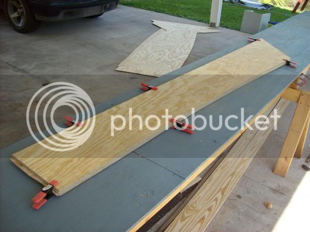

I got right to the job at hand right after lunch. Four panels designed, cut, edges faired .....ready to settle on the exact length. Ended up cutting them to give sides 14' 4" long . The pirogue should finish up at close to 14 feet. 4 inch reverse curve cut in the bottom edge.
An hour or so later, the two sides with the glass butt joints curing. I thought about doing both sides on both pieces at once, but that seemed to be flaunting Murphy's Law.

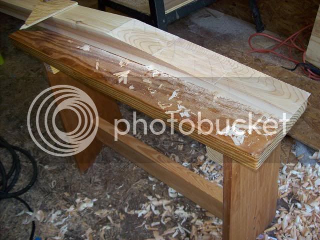

The pine I bought to make the chines seemed to gain more weight everytime I moved them. Out of curiosity I weighed them........21 lbs!! Not that I was going to use all of them, but that's still a lot of weight. I returned them to HD and found some decent cedar at Lowes. I figure a bit more than half the weight. Shorter pieces so I have to do a few scarfs. Good practice to build up the ole woodworking skills.
A jack plane with a convex blade profile followed by 60 grit paper on a long sanding board did the trick in short order.

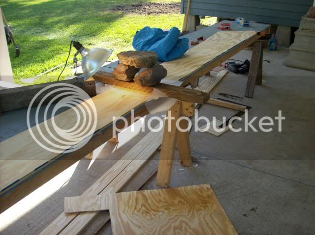

I ran into a little snag with the butt splices. I think the fit of the two pieces was just too close and what little epoxy there was in the crack got abosrbed into the edges. The glass patches held enough to turn both pieces over. I'll widen the crack some with a saw kerf and apply more epoxy and the other patch.

Did you have to much weight on them with the three blocks ?
That would squeeze the epoxy out and make for a weaker bond.
On the ones I do they panels are as close together as I can get them making the seam as small as possible. The epoxy gets into the seam but also stays with the glass and bonds it to the wood without any loss in the epoxy or voids.
I do use a lighter weight over the seam then most folks do.
2,326
Chuck, the weights were not pushing the joint tighter, they were there mostly to line up the two panels. The glass layed down on the panels well.
After turning the panels over I opened up the joint a smidge and worked the epoxy in there and put on a layer of cloth. I might just go over the first side with another layer of cloth if it needs it.

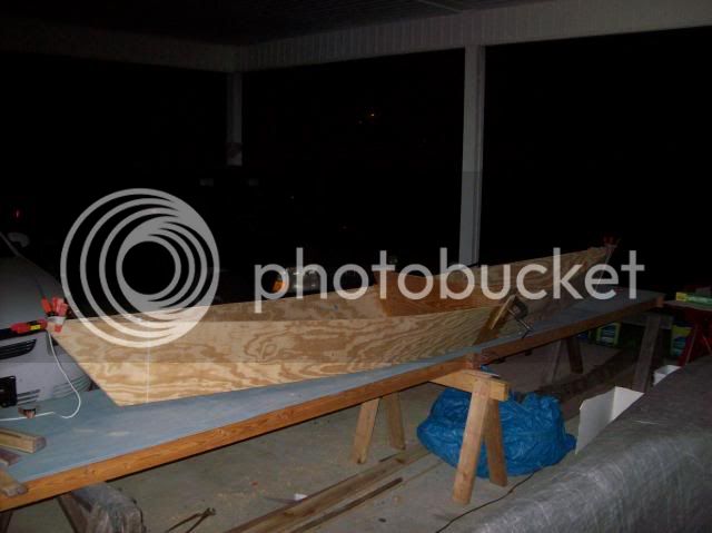

Put the pirogue on the centerform to get an idea of the rocker and the sheer line . I allowed about (.....) this much for adjustment :wink: :mrgreen: so I knew It was going to need trimming. Cut almost 2" off the bow gradually reducing to 1/2" at the center. Much better to my eye.
Tentative specs: 22" bottom, 14' length, approx 30 degree side flair, rocker---1" , sides are 12 1/2" at ends and 9 3/4" amidships, 4" reverse curve for the chine.
Plans are for some type of ventilated gunwhales, two color paint job--- darker outside, light but strong breast hooks. Might go a touch lighter on the gunnels and put in a thwart behind the paddler if it needs it. I hate thwarts in the front of a boat. With the fairly narrow 22" bottom, I might get away with no floor or side ribs.
Looking good! :)
What is the beam width?
How many splces in the floor?
You may want to consider ribs placed over the butt splices. They will act like scabs for the joints, and reinforce the floor and brace the sides. You can save weight and material if you only put side ribs where the sides are spliced, unless you need/want more bracing for the sides.

I didn't measure the beam width, but it's the same center form as the aluminum pirogue and that one had a beam width about 10" wider than the bottom.
2,326
It'll probably have one splice behind center. I'm thinking of going with a patch. That will help stiffen up the floor. I'm not planning on any side ribs but will use one about at center if it needs it, or maybe a light thwart there.
