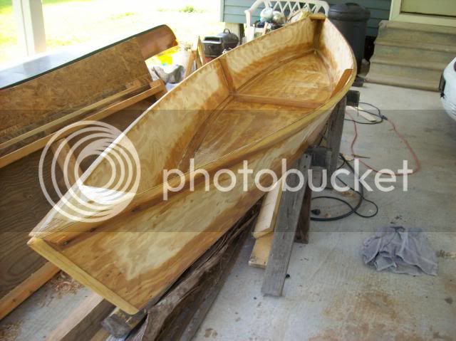

To stiffen up the sides, I decided to do a pretty standard center rib. I glued in the side ribs tonight and will put the cross rib in tomorrow. A good sanding after that and on to paint. :D

Good idea, jp. I did solve the problem of the flexing with a center rib. She's rock solid now.

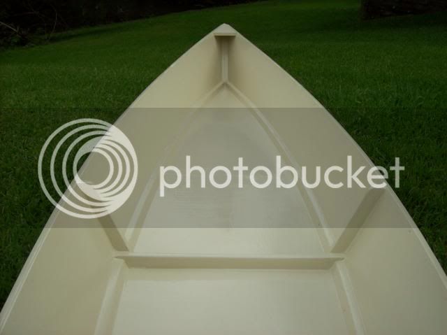

Woodwork and epoxy is done. I stretched what I had left of the epoxy to seal the most important areas. I'll paint her up with two/three coats of oil based paint. Weighed her in at 42 lbs. Paint might add a couple more. I can live with 45 lbs very well. :D
Final specs: Length - 13' 11" ........... Bottom length - 12' 2" ........... Bottom width - 22 3/8"........... Max Beam - 31 1/4" ............ Flair - 25 degrees ........... Rocker - 1" .............Cutback on bow and stern 10 on 12
I relaxed the flair a bit to get the rocker down some. Stil has plenty enough to be very stable.
Some thoughts: I found western red cedar to be just adequate for structural members on a build like this. Does not have the strength to hold fasteners well. It's also VERY splintery and light weight. Without epoxy, it would not be very useful.
The sanded pine ply impressed me with it's quality and it's virtual absence of voids. Strong enough and light enough without full glass coverage to make a strong boat.
Forgot how many more steps in a traditional chine log build. Fun..but more things to go wrong......especially for me. :oops:

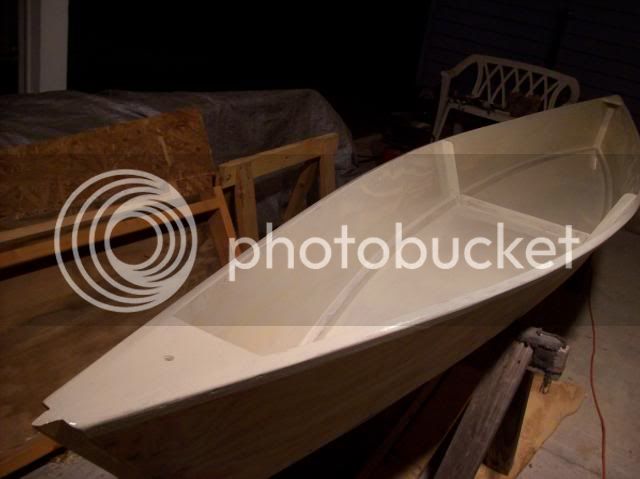

I finished sanding. The boat wasn't finished with sanding........I was finished with sanding. :roll:

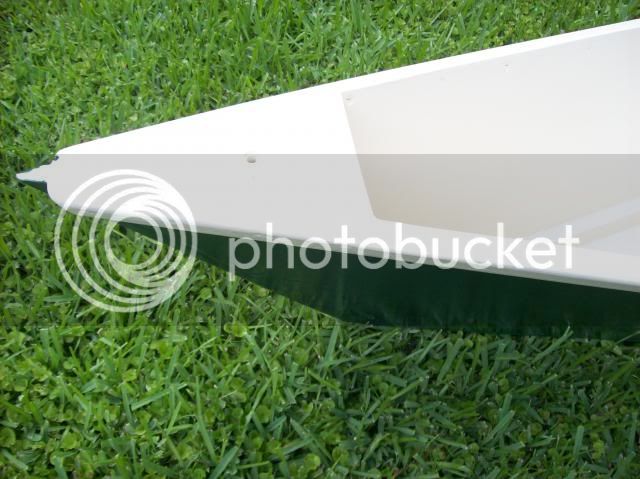

Put on the first coat of almond oil based paint.
The bare pine was thirsty! The inside will probably need at least one more coat................depending on my mood. :wink: Paint can really cover up a multitude of "character" features.
Home Depot didn't have the color I wanted in oil based so I bought a can of Rustoleum dark green for the outside. Kind of had an urge to paint the outside the same color as the pirogue from a few years back...... the one in my avatar. I still might if I can find it at the local Ace Hardware.
Joey, that looks like a pleasant color to stare at whilst waiting for a bobber to go down. Should be easy to clean, and easy to find a dropped hook or sinker there. Also, easy to spot a water moccasin who may have slipped in. :wink:
Jack, you ought to see me do the "Moccasin Two-Step" ......... a take-off of the "Gator Boogie". :shock:
That Rustoleum flattened out to a nice gloss with just the first coat. Two more and then two or three on the outside should give great protection.

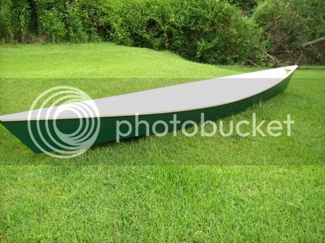

The last coat of paint went on the pirogue this morning. :D At least the last one for a while.
I have a few paint drips to take care of and I'm planning on letting the paint cure until next weekend before I take it out. I can already tell that the Rustoleum is a much harder and slicker paint than the Ace Hardware oil based I used on the red pirogue.
Final weight........45 lbs. (20.45 kilos for my Aussie friends.) VERY satisfied with that weight. Same as the Swamper kayak.

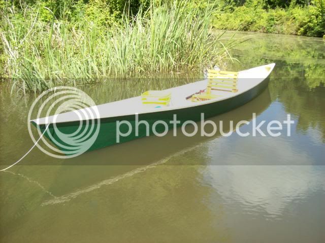

Made a fishing trip to Lake Verret to test out the pirogue. One fish in the boat and 1 gar that gave me short fight and got off.
As expected, she's a little slower than my kayak and the 16 ft pirogue of a few years back. Cruises pretty good at a little less than 3.5 mph. Tracks straight and turns well. Very stable with the 4 1/4" seat height. Weather cocks a bit like most open, high-ended boats. It defintely needs some kind of foot brace for comfortable paddling
She draws a little over an inch with the seat and riser, anchor, rod, water bottle and bucket with fish and 1/2 gal of water.
The almond color gives my camera fits. The color and details get washed out in the sun. It's a good color for a boat interior, though.
