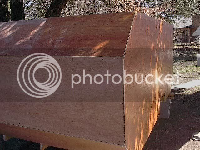

Well still no pics but got the roof, back and part of the front outside skin on. I promised my better half I would take her to red lobster :thumbsup: Now I am to full to go outside and take any pic

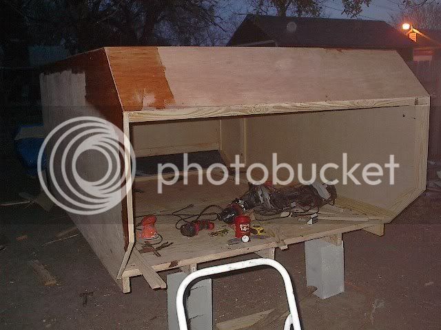

Got a little more done today , finished sanding and putting in the rest of the braces for the front and back walls and got all of it skinned but the front
We are going to get some rain tonight so I put the saturation coat on everything I had put together.

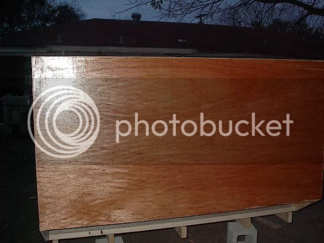

Got my finish coat of glass on the roof and about half sanded out, all the rain and no leaks :lol:

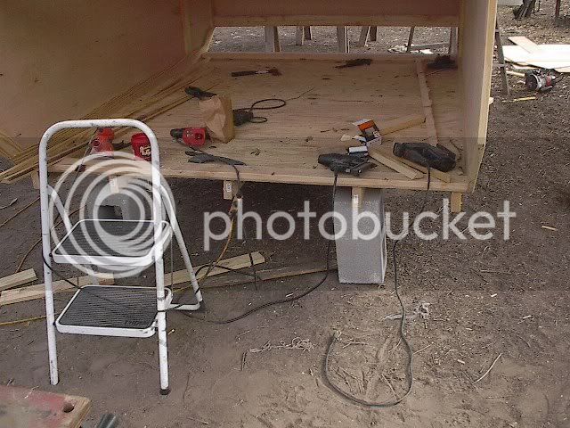

Built and installed the inside fenders.
I have about half the framing for windows installed should be finished tomorrow with that.

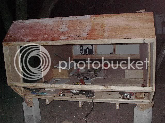

I changed a few things on the tepee from the measurements we used on the coyote.
On the front profile I used a 12 and 12 (45%0 angle top and bottom, I did this for more room and battery mounting in the future. The back has a 8 inch tall 12 inch foreward slope ,I will get into why later.
On my camper I will be using a 38 inch wide mattress for when I am camping solo and two of them when my rib goes, so I moved the door foreward on the tepee to accommodate that.
The back wall will carry the ac and I also want to build some small cabinets and a tv stand ,so I braced the back wall stronger.

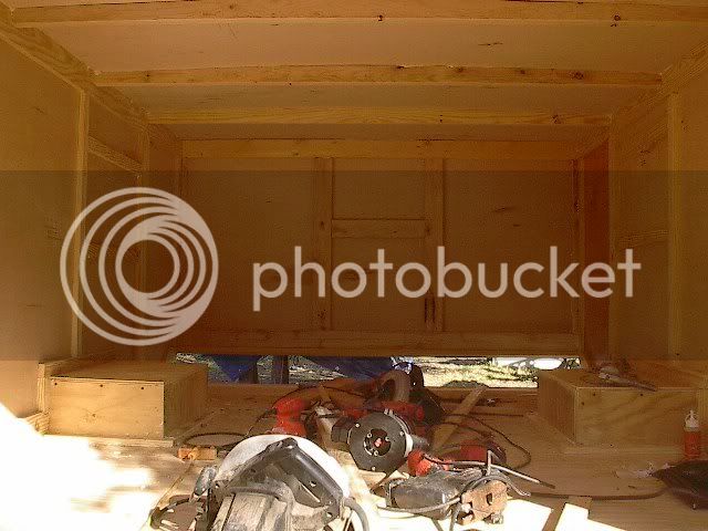

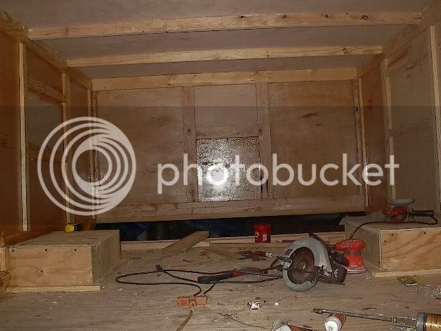

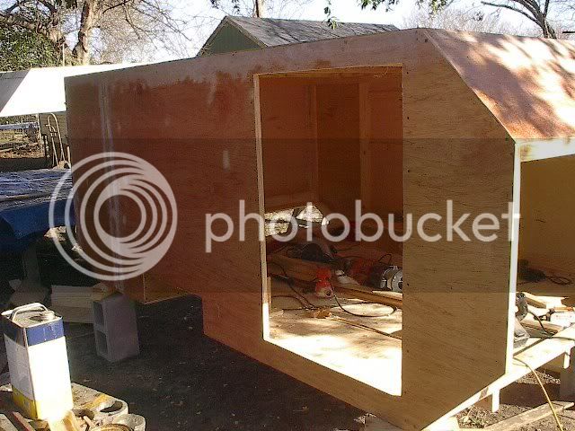

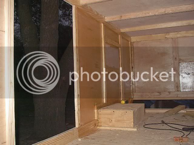

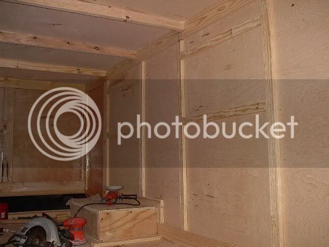

Got a little more done and some pics :lol:
I moved the door foreward and cut in and framed
fenders built and installed

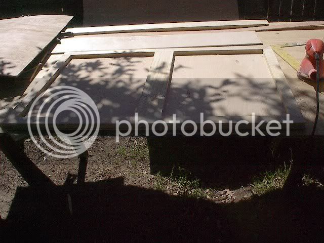

windows framed out.

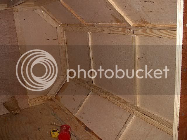

put my saturation coat on the inside walls and back

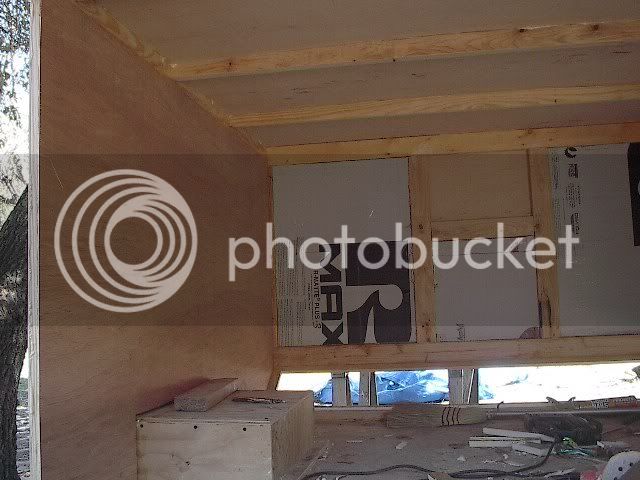

In the morning I will start cutting foam and installing.

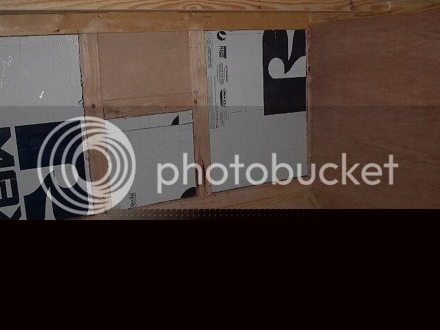

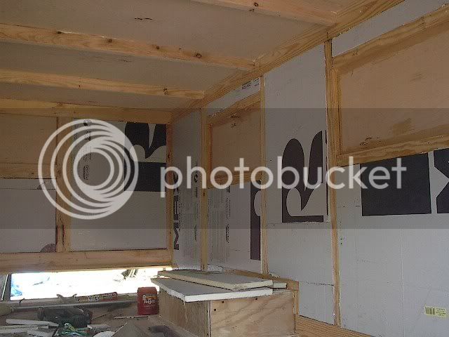

Got the foam installed today on side and back wall
interier wood put up on side walls
Installed the ribs accros the front
Its ready to close up now.

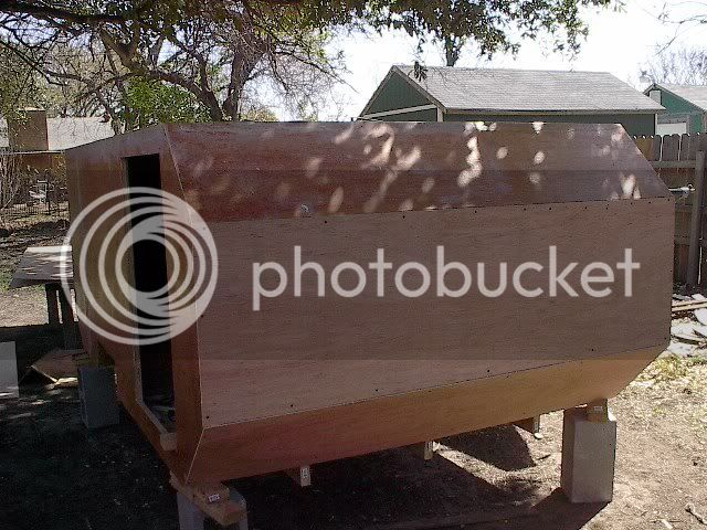

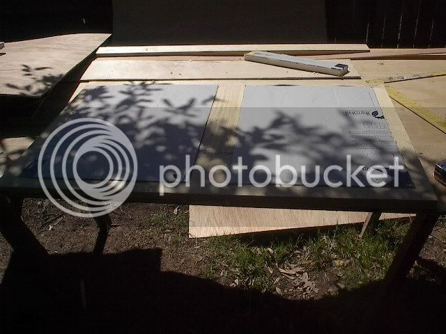

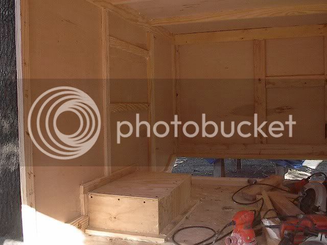

Had a pretty good day today.
Framed my door.
Insulation installed
Got the rest of the skin put on outside of the tepee
all the framing installed inside
It is ready for a saturation coat of glass on the installed parts tomorrow.
