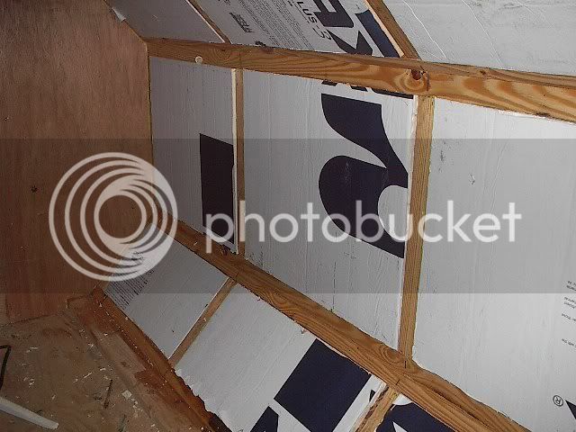

Got the saturation coat on the inside areas this morning ,then cut and finished installing foam.
Got all the inside skin installed

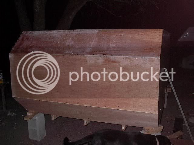

Started filling screw holes and seams on the outside.

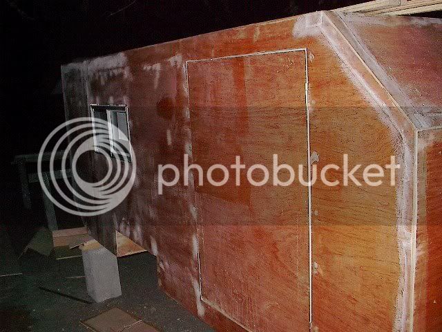

Got the door fit and ready to hang, most of the screw holes filled and the seams ready to be taped and glassed.

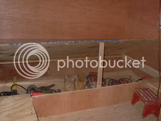

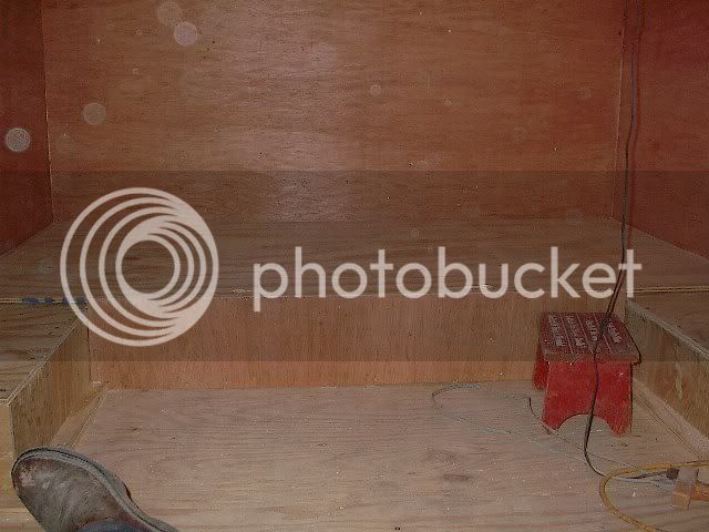

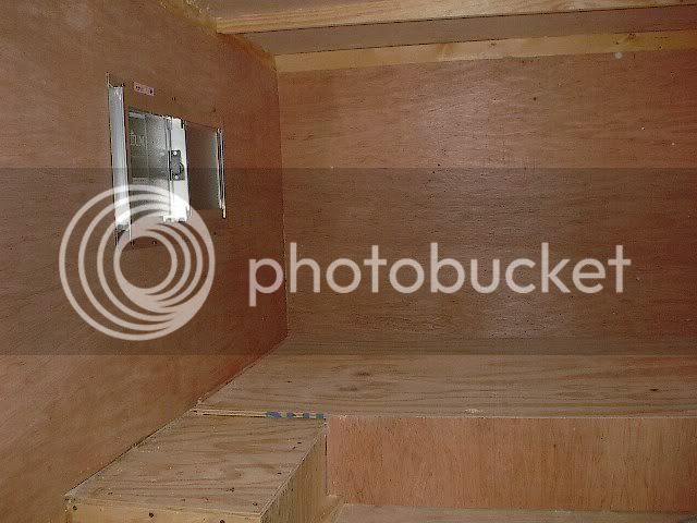

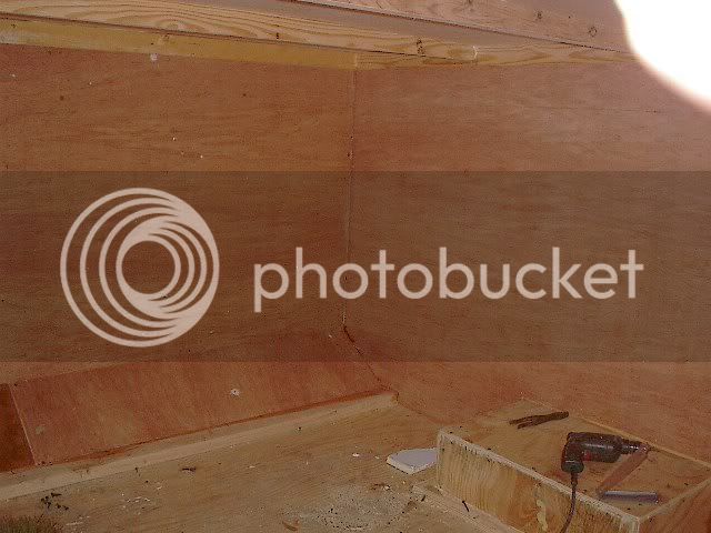

I had a pretty good day today. Bed is framed out and top installed
It is hinged so you can use the space under it as srorage

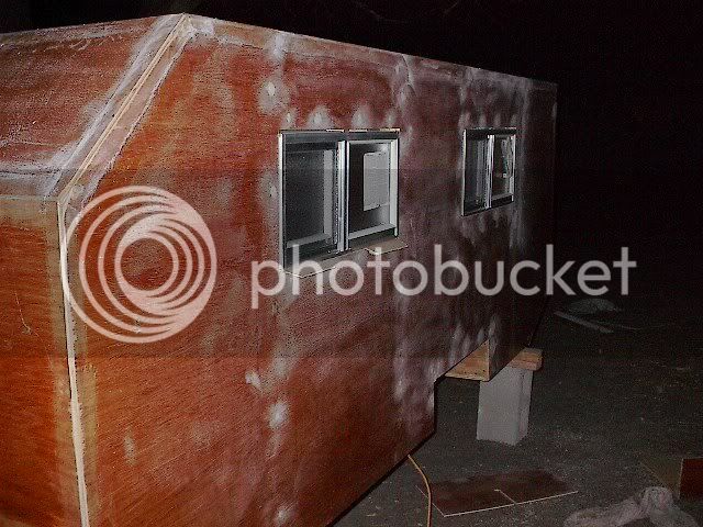

Got the window opening routed out and windows installed
Door is hung ready for latch.

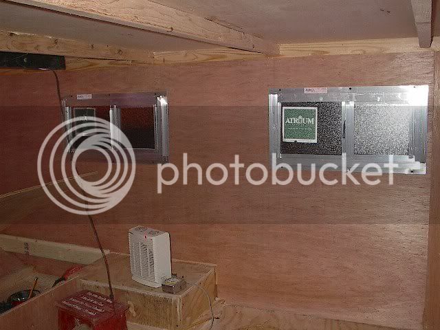

I closed it up and put a small electric heater inside within minutes I was turning it off.

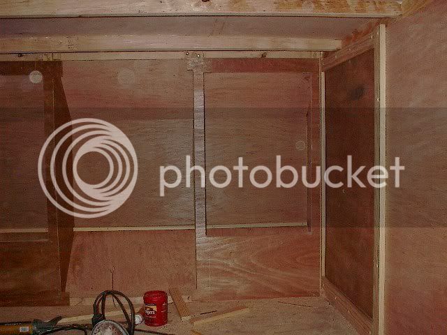

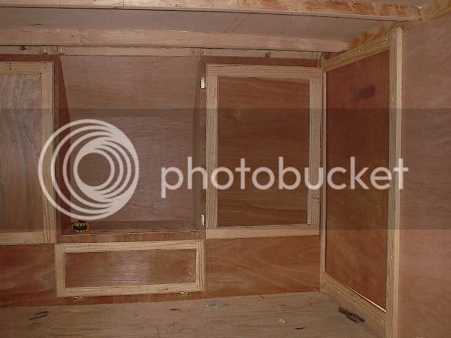

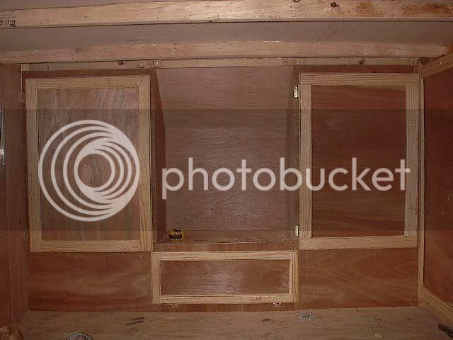

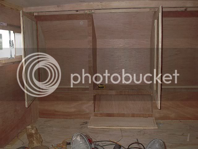

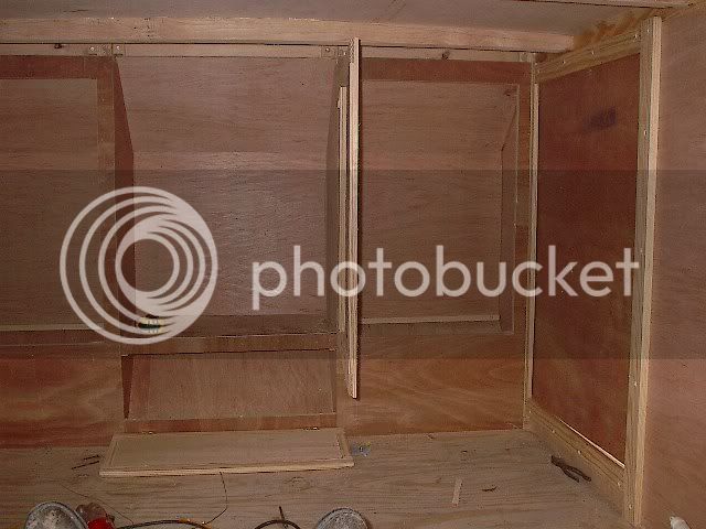

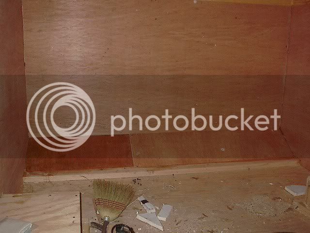

I got the door for the cabinets framed and hung.
The left hand door opens inward and the center door opens tward the floor, I did this for ease of reaching things from outside the trailer with out having to get in the trailer.
The door on the left opens to the wall.
The cutout center section is for the camp chef stove when I buy it.
