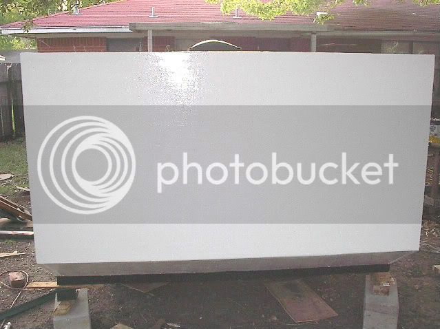

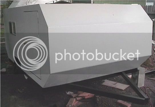

I finished the box on the Tepee today ,put on the finish coat of paint,

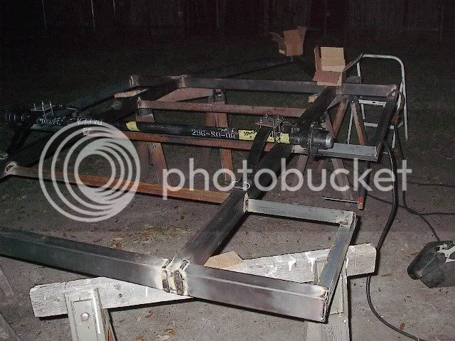

Went and bought tubing and axle for the frame
Now the easy part , should have the frame done tomorrow..

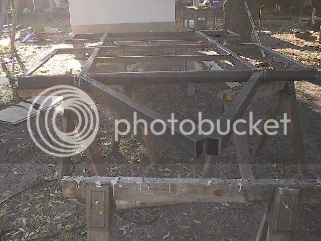

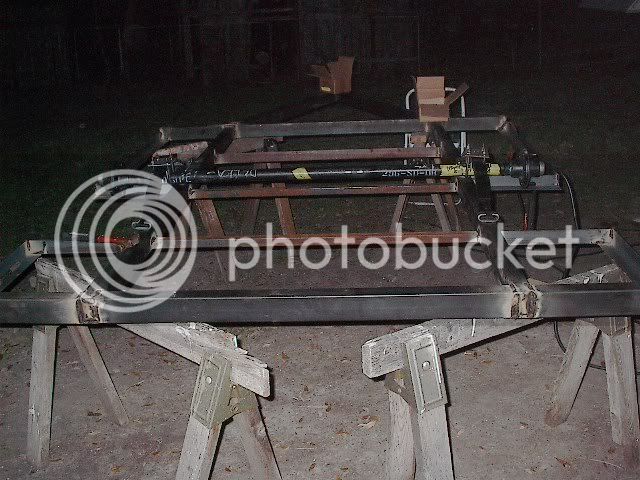

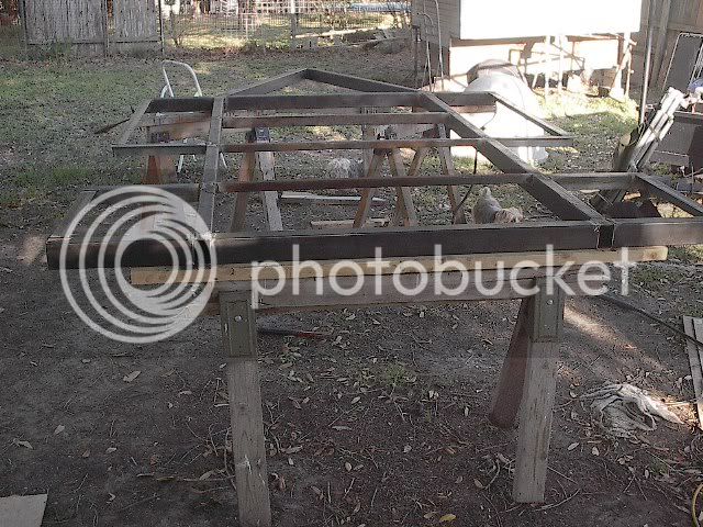

I had a pile of tubing and angle at 12 noon

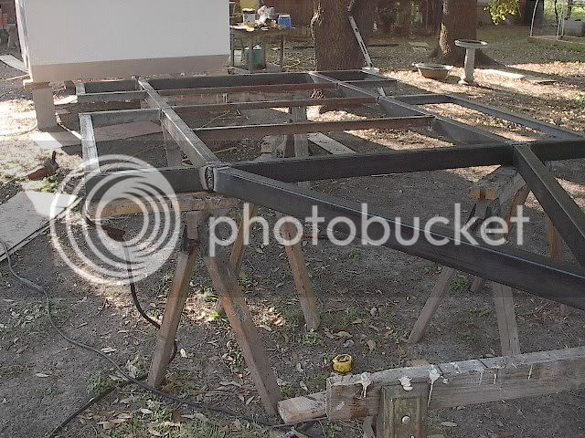

Before long it was cut up and tacked up like this
Welded the top out and flipped her over
Welded the bottom then installed the axle
She is ready for paint tomorrow.
Not to bad for a old fat man 7 hours including a couple coffee breaks
Good job, Ron. I can tell you're a steel man and this ain't your first rodeo.
One thing I was wondering about. Why the top of the camper first and then the frame?
Friend Ron,
Kin ya rassle all that angle iron by yerownself? It dont look like yer good help cares fer weldin' sparks. [chuckle]

I did the box first ,because I was just winging it on the design, I knew I could build the trailer to fit.
Bear ,yea I handled all the iron by myself,I am the chief and just an indian all in one. The pups are just my scouts.
Ps I now I am not use to working this hard,had a few stiff moments this morning. :twisted: Lets see how many of you have to sit on your hands to keep from running with that last statement.

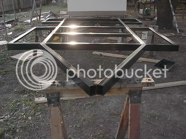

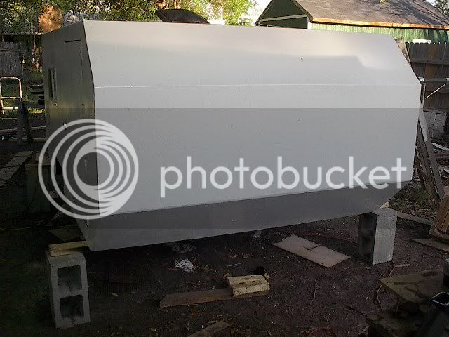

Got the trailer frame bottom painted then flipped it and did the top
Got the bottom of the box covered in undercoating and set the block so I could roll the trailer under it and set her down.
Pick up the tires and wheels tomorrow and the back to work on her.
Very carefully :lol:
After wheels are installed I will roll it under the box ,then take a small hydrolic jack to raise it take out the block on the front and lower it down to the frame, then the same process for the rear.

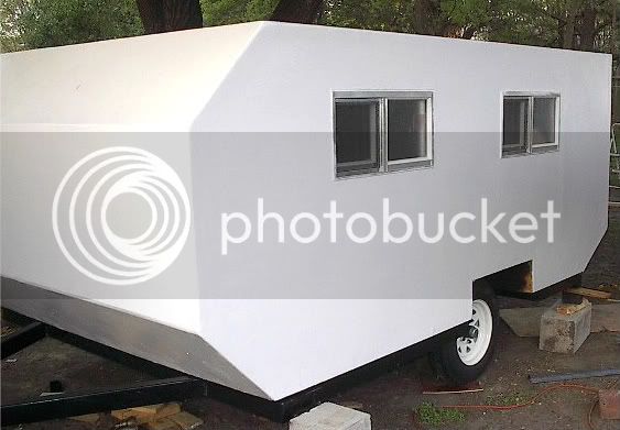

These are the days that are little milestones. Drove 30 miles to HB to get wheel,tires and a hitch.
I came home installed the tires did a little jacking around and here is what happened
I was very happy with the fit on the frame and overall height.

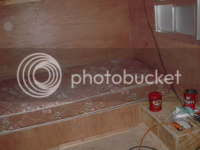

Got my mattress inside ,now I have a bed in my doghouse.
I measured the jeep and the frame and it is going to be a good fit on the height of the hitch
It is starting to look like a trailer.
PS I found out I have some competion ,I left the door open came back in a few minutes ,my black lab was laying up on the bed ,I think he thinks I am building him a dog house.

trailer is 2 by 3 11 gauge rectangle tubing with 2by 2 1/8 inch angle for outside frames
2000 lb axle

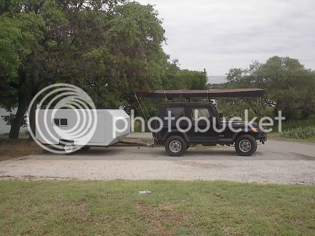

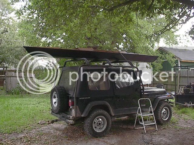

I got my rack usable ,loaded the yak . This setup is going to get some use .Everything will clear pulling the Tepee.

I hate to ask this but the way the TV is set up is good but what if you get into one of those little Texas rains , showers , sprinkles ya know 6 inches per hour with the open cockpit being up on the TV. ?????
Chuck you just drive faster it blows out and if that doesnt work I will pull the drain plug.

I made a little trip with the Jeep and Texas Tepee this weekend
I got 17 miles to the gallon with yaks high rack and pulling the trailer,I was a happy camper.
