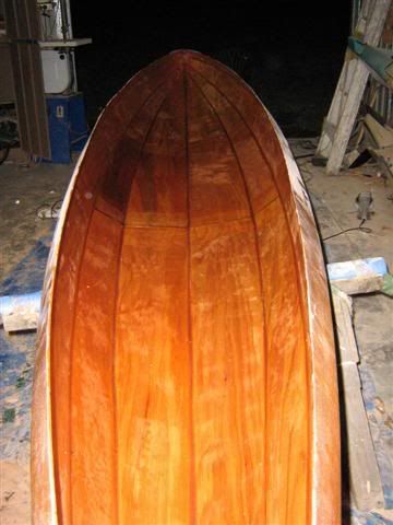

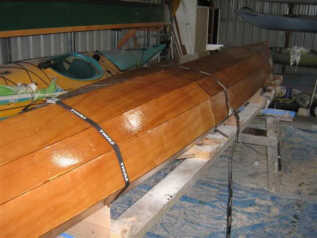

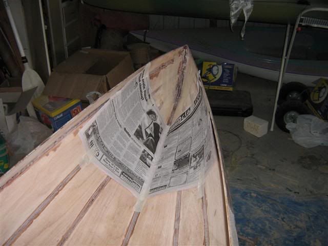

- Pile of planks,
- Planks tied together,
- Hull fared,
- Now epoxy saturated.
All in a matter of days! It's making me look bad. I just managed to glue the bottom on my pirogue having had the sides joined and rails glued for two weeks (I have been a poorly though).
Seriously Mick it is looking great. Nice lines and a really nice finish on that hull. Go for it!

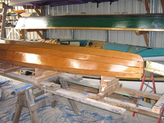

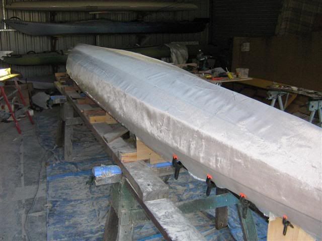

Back to work now for a few days. By then the rest of my epoxy and fibreglass mat should be here.
Hopefull in a week or so will be able to lift her from the ' back. Inside should take a lot longer.

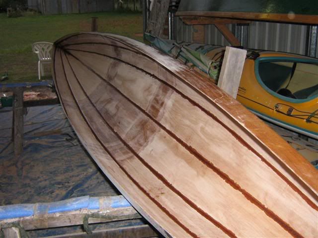

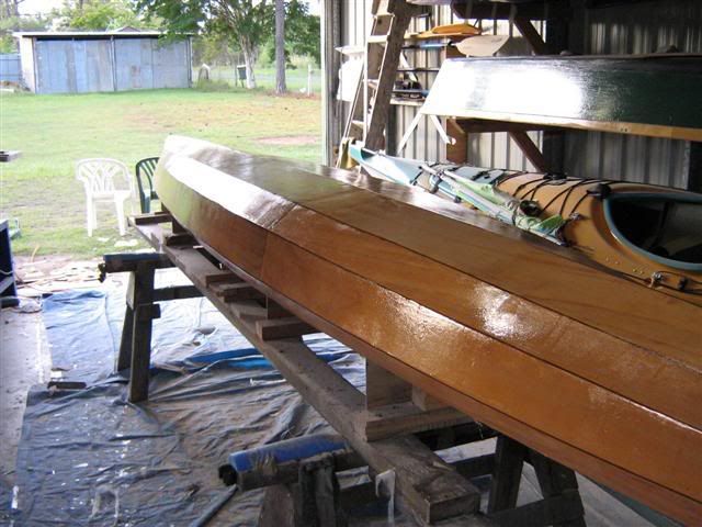

Wet out.
Third coat. (in this heat, the resin is going off in 3 hours :D )

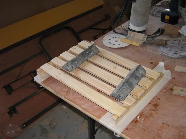

Sit backer Seat base started. Thanks for the idea Chuck :D

On the seat support , I could not tell from the picture , run a piece of wood doweling along the front and back edges of the slats for the seat.
This will give the straps on the sitbacker a lot more support and something to snug them down against. The doweling I had on the front was to low for the straps to go around. I had to run the front strap on the slats and managed to break one of them.. a wood dowel in place of it corrected that problem.

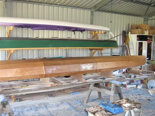

OK,
Ready to come off the strongback,
Off. and Jack, the stations came out easy :D

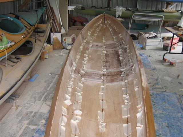

Filleted
Thanks Jack,
I look at the lines of this boat and cant help but think that at around 15 feet or so and fully decked, It might make an excellent, high volume sea kayak, or day, or multy day tourer. As it is, I think it will be superb for what I want it for.
I know the heavily raked and very high up-swept bows are in fashion at the moment, but for the life of me, I can't see any advantage to them. I would think that if they were such a good thing, the Inuit would have used them.

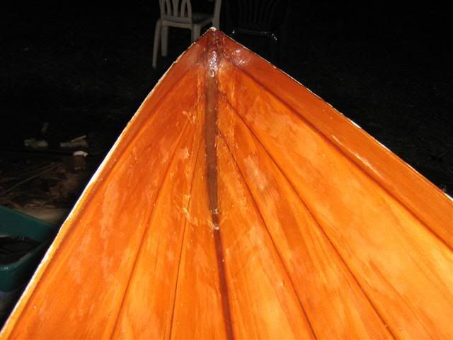

Inside is filleted and cleaned up.
Saturation coat and end pours are done.
