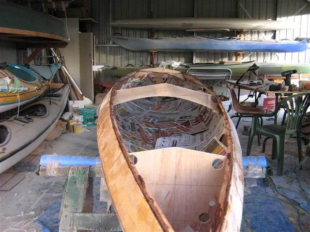

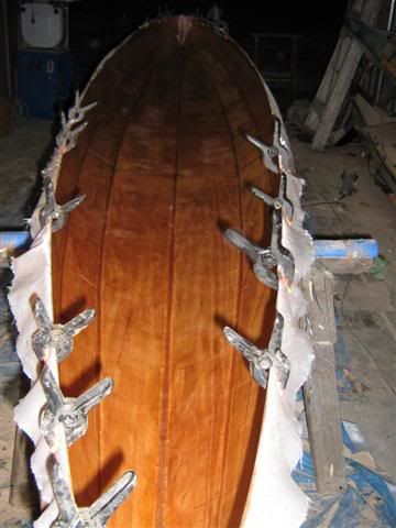

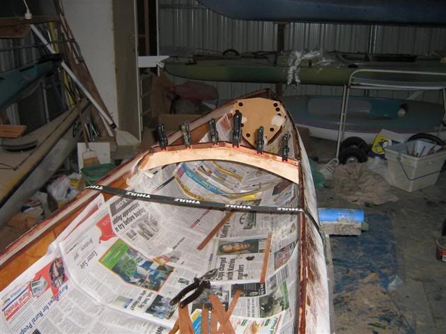

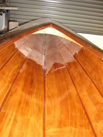

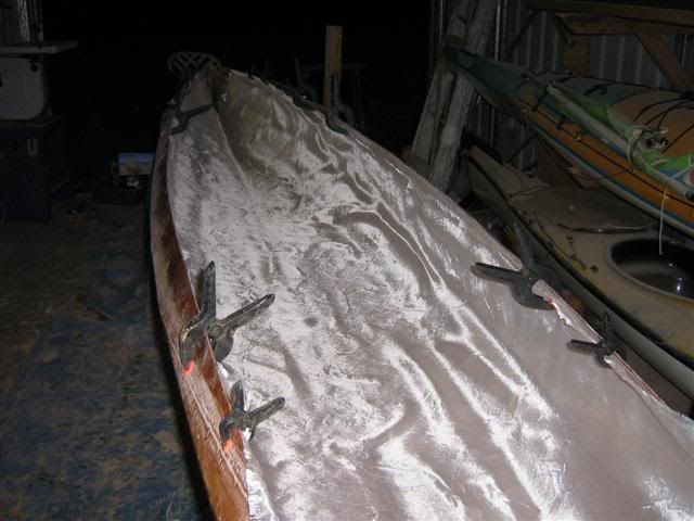

Fibre glass (85 gram woven matt) is fitted to the inside.
Wet out coat is on.

Hi Mick,
85gram! My supplier either sold me 120 g or 200g... could that be why I had trouble wetting through the fabric?
Hi Steve,
I don't think so. I used 200 gram tight woven stuff on my wadefish and had some trouble with it but not as much as you by the sound of things.
What temperature was it where you were trying to wet it out? I think if where you were working was cold, it probably would affect the viscosity of the resin and make it more difficult to work into the glsss. I don't know enough about epoxy to say yay or nay. I just find the lighter stuff easier to work with and less thirsty on the epoxy.
A few hours with plenty of real course discs on your ROS will hide a lot of sins mate. I wouldn't stress over it too much. i spent a lot of hours cleaning up my stuff-ups on the inside of my swampgirl. At the end, you couldn't even see most of them.
I would definately be going with the 125 gram stuff on the inside though. ( if at all) some here son't use glass on the inside at all and that seems to be strong enough. I have'nt been game enough to try it yet.

80g? Is that like 80 grams per square meter? If so that converts 2.4 ounce cloth. That's pretty thin. Looking at your pictures Mick, I'd swear your cloth is heavier than that. But I could be wrong.
120g converts to 3.7 ounce which is still thin but better. 200 gram converts to 5.9 ounce which is the standard for canoe and kayak building.
The weave is what can make glassing easy or difficult. If it's tight weave, then the cloth has a tendency to be stiff on not want to conform to corners and such. 200g e-glass with a normal weave shouldn't have given you that much trouble. Unless it has some special coating.
I say all of this not chastise, but to provide information. I want you guys to be safe and enjoy your boats. :)
I'm not sure what the appeal of a tight weave cloth is. I darned well know (at least some of) its faults. As Matt says, it does not like to conform to corners, bends, etc. I found that it doesn't like to conform to ANY curve except a gentle, outside curve. And even then you'd better line up the weave with the centerline of the boat; do not have it offset at any angle. NEVER AGAIN would I ever use a close weave or tight eave cloth.
Loose weave cloths will easily squiggle themselves around to conform to all the curves, bends, corners, etc. that are the real life situation in building a boat. Tight weave for flat surfaces, maybe, but never again for real boat work.

My choices are either 85 gram or that 200 gram tight weave stuff. My LOCAL surplier only sells 3oo gram very tight weave stuff and I am guessing it would be ever worse! I have used a little of it elswhere and it is a total bitch to wet out and doesn't dissappear completely - ever. :evil: I wonder is Steve might be using something similar.
The 85 gram stuff I have been using has stood up very well on my swampgirl and pirogue. i am trying to keep weight down on my south wind and the light stuff is just soooo much easier to use. The hull seems very rigid and strong as it is at the moment. if I think it is necessary, a bit later, I will put another layer of glass over the bottom.
I used the 200 gram cloth on the outside of my wadefish and had trouble getting it to ly flat when wet out. also had trouble getting it to conform to the contours of the hull. I think it also made the boat considerably heavier than it needed to be. (but it is very strong though) :D

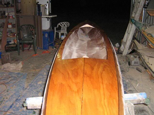

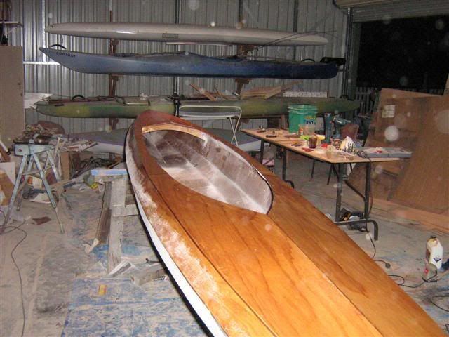

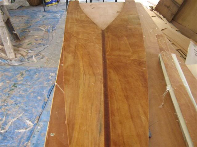

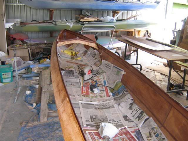

Decks are on. :D :D
Saturation coat, Nice & shiney :D :D :D
Been doing most of my work at night. Temp has been 100 plus these past few days and it been just too hot in the shed to do much.
A cool South East change has just arrived though. Just in time for me to go back to work.

It is looking like a mighty fine boat. I especially like the grain in the wood for the deck , that is pretty.

Every day, I walk around her and just can't believe how pretty she is. my workmanship can't do justice to a design such as this.

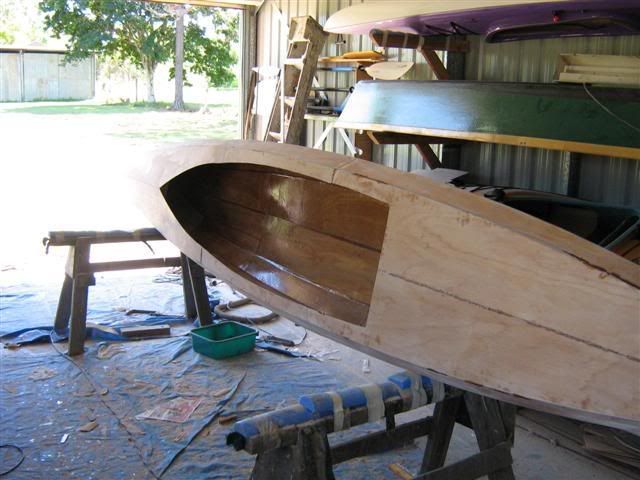

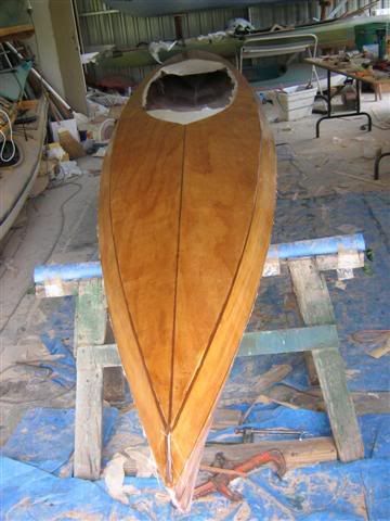

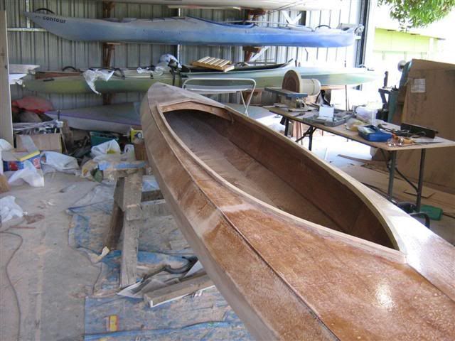

Deck is glassed. :D
More sanding,

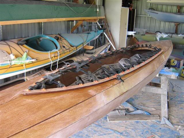

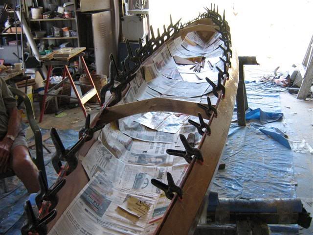

Workin on the coaming :D

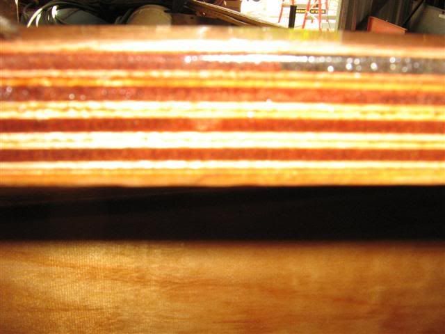

Several layers of ply, cut to shape and then laminated one on top of the other to build up the height to what I wanted. Will take tsome macros today.
I had a stack of off-cuts from the various builds and decided to use them. A lot of work but I think it will have better load capacity when tied to my roof bars.
