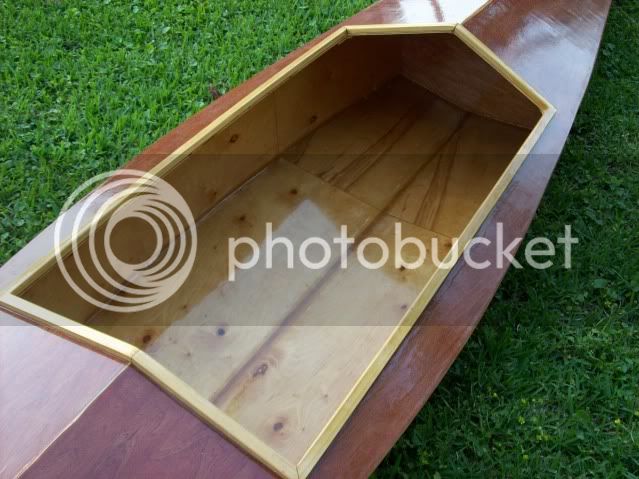

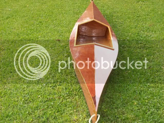

Very nice job. And I like the accent piece in the bow. Can't wait to here how she feel after your trip.
The accent is actually a bit of stain brushed onto the saturation coat and under the glass. Partly for looks and partly to cover a couple of blemishes from the close quarters bulld. Looks like exotic wood from a few feet away.
I did something neat for the bow and stern grab loops. I used hollow braid rope and ran the ends back inside the core and tapered them so they disappear. Very strong too. I made up a test sample and put my whole weight on it and it didn't budge. Makes a neat, almost seamless loop.

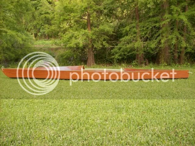

Not too bad for a boat pretty much designed on the fly. I LOVE her. Dang good fishing platform and she'll eat up the miles too.
I want to thank everyone for their input on this build. Special thanks to Matt from JEM( design was VERY loosely based on the Laker), Chuck, Tx River Rat, piper, kayak jack,seedtick and keith. Pardon me if I left anyone out. It was a great experience for the most part. Building in winter SUCKS. Luan ply did a bang up job structurally but not aesthetically. Most of the problems with the fine details were , in part, caused by the thin outside veneers of the luan being too thin to sand properly. The NEXT one will be built with the good stuff. But, all in all, I am tickled pink with the outcome.
