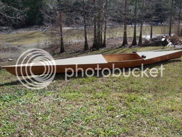

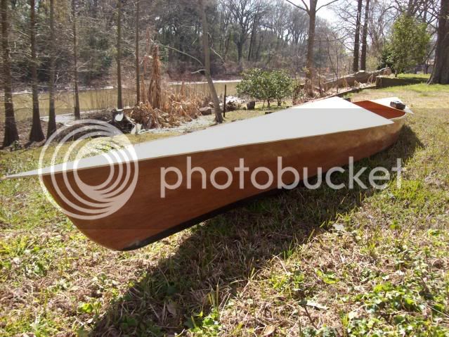

Beautiful day here so I fitted the decks on the Swamper. Getting fired up again. :D
I put about 3/4" of swoop in the front deck line and about 1/2" in the rear deck line. It doesn't show well in the photos, but it is just enough to give it a little character.

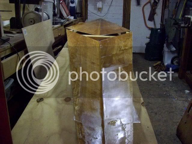

2,326

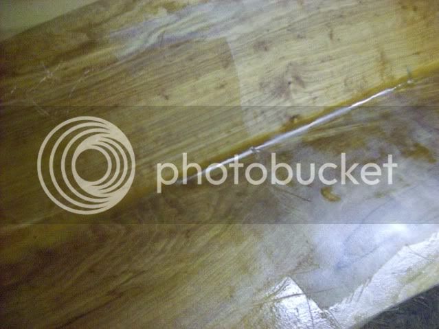

Almost short-sleeve weather today. Warmed up the shop and did the fillets on the underside of the deck panels. I tried something different to speed this build along. After the fillets dried to the bubble gum stage, I layed out the off cuts over the bare wood panels and poured the epoxy in a line down the center. I used the roller to press the glass into the still pliable fillet and then wet out the panels. It actually was easier than I though it would be. I mostly let the roller do the work and slowed the strokes down to allow the epoxy to seep into the glass. The light colored areas are glare- the glass is well saturated.
I'm letting the shop cool down slowly to minimize any outgassing of the wood. I figure I saved myself a week or more of waiting for the fillets to dry, sanding them, putting on a saturation coat, letting it dry and THEN applying the glass. We'll see.
2,326
That's why I was letting the shop cool down slowly- little or no outgassing. Worked great. No excess bubbles and everything looks like it's stuck down tight.

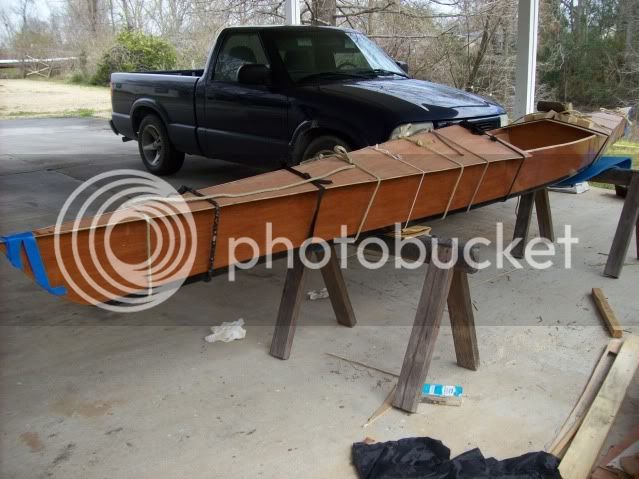

Good weather :D . There's a big yellow ball in the sky and everything is so BRIGHT! :shock: I set up the kayak under the carport and glued down the decks. Everything fit pretty well. I found a new use for all those little pieces of rope that are not good enough to use but too good to throw away. Worked pretty good. You snug them down tight about 2" below where they need to be. When you push them in place they wedge pretty tight and make an excellent clamp. Friction holds them in place and they don't move.

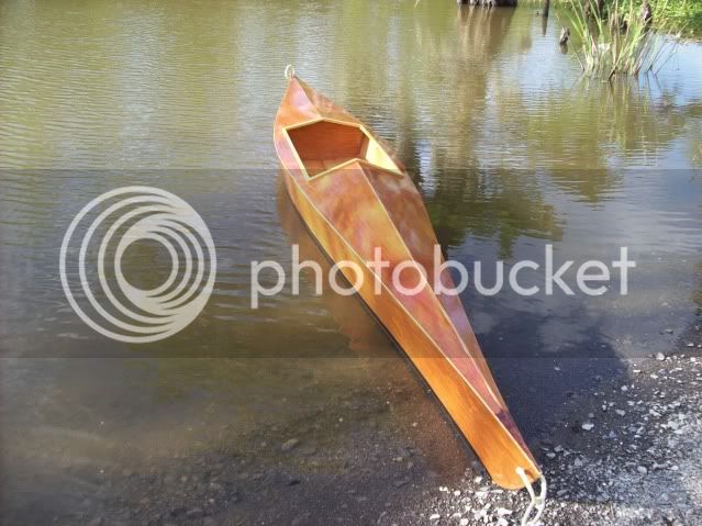

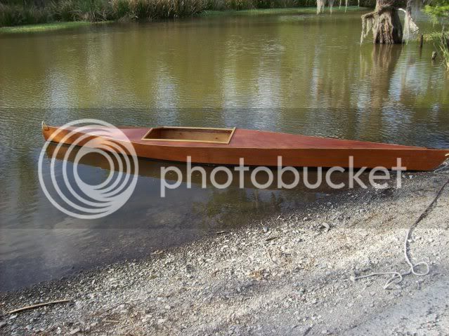

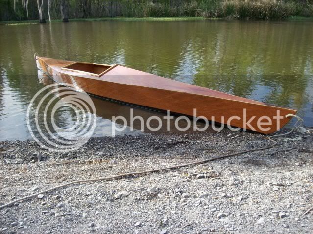

She's DONE! Finally got her in the water. Very easy to get up to speed and very easy to keep there. She turns with sweep strokes pretty well but likes to go straight better. The cockpit is a cinch to get into and the front deck is just long enough to prevent paddle drips.
And my favorite shot.
I'll be putting some miles on her this weekend, for sure.
Almost forgot.
Specs: length 15'9" ----- bottom width 22" -------- max width 26.5" -------- cockpit 18.5" x 38" ---- weight 44 lbs
