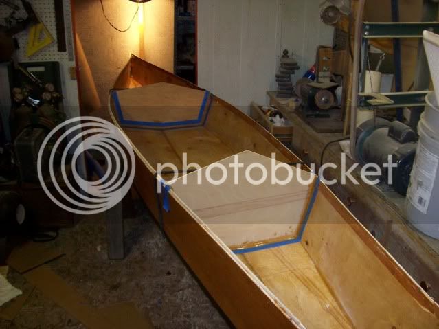

Put the kayak in Grand Bayou this morning to see how she floated so I could start with the bulkheads. She floated with an inch of the bow and stern clear of the water- pretty level. I sat on the floor and she was really stable. Being about 27 lbs., she responded to the paddle by leaping forward with little effort. The glide was fantastic. I moved around some to get the draft about right and marked where I wanted the bulkheads. Came home and started measuring for them.

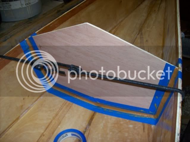

I did something different with the end pours. When I glassed the skinny inner bow area, I folded a piece of glass and wiggled it into place leaving about 1.5" of space between it and the actual bow seam. After it cured it left an open topped cavity that I filled with the boat sitting level. No horsing the the boat up against the house.

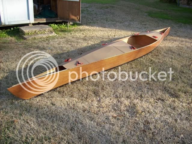

The last fill coat of epoxy on the inside is done. Next come the decks. Tried a little cardboard to get the feel of what they will look like. I'm liking it. :mrgreen:
The templets are oversize. I''m thinking I might make the front and rear of the cockpit curved - kind of a long oval a little fatter in the rear.
This boat photographs kinda strange. It does look like the bow is LONG, but it is just an optical illusion. I had it in the water to test cockpit location and it behaved well.
Check out a square- on picture of the kayak. It gives a better idea of proportion.
