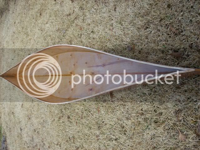

I put another coat on the outside of the kayak after sanding and really scrubbing with soap and water. Seems to have gone on smoother. I turned it over and gave the inside a saturation coat.

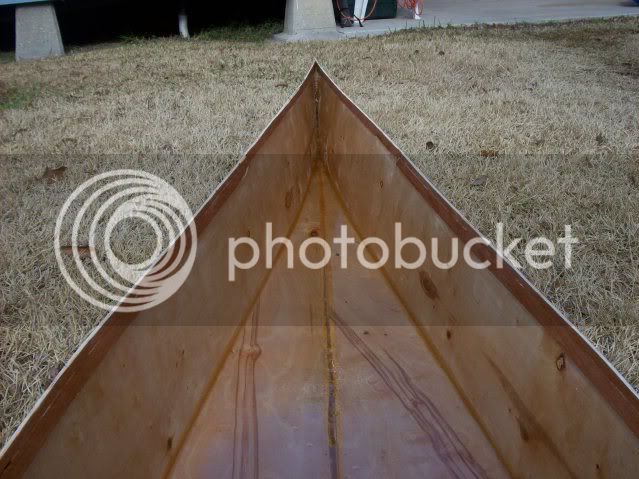

Here's a shot of the paddler's view over the bow.

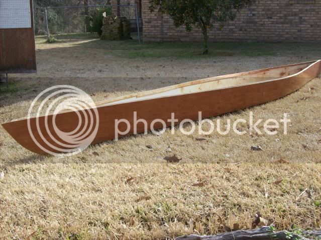

Surprisingly, the weather was warm enough that the inside coat dried to the just tacky state. I started glassing the bow and the stern back about a foot. THAT was fun with the narrow pinched-in bow and stern shapes. I had to work with a paint brush held with ViseGrips to reach way in there. It ain't gonna be pretty, but only the spiders will see it after the decks go on. I think I'll glass the rest of the inside with seperate pieces.

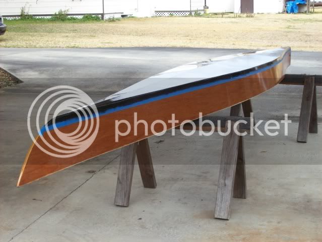

Making progress. The weather has warmed some so I put the first graphite coat on. I'll let it cure and put it in next weekend to test for the bulkhead locations.
The boat has a 20 foot bottom. Bottom looks good from 20 feet- definetly not close up. :roll:
